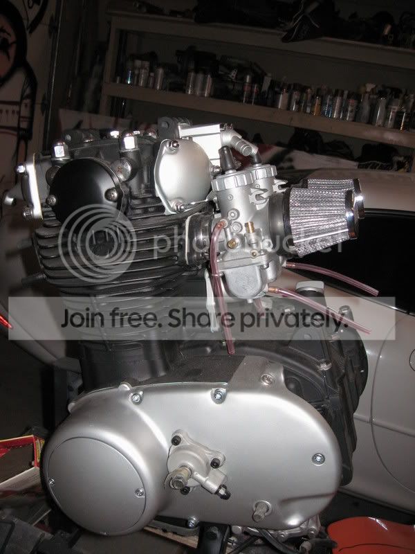

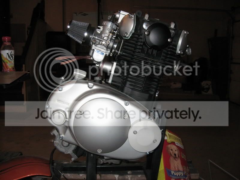

Anytime you feel like making a 2nd motor, feel free to send one my way - looks awesome and up to snuff with the rest of the bike. I like the hydraulic clutch kit.
Some details on the finish work on the engine would be great.
yea what all do you want to know about the motor? powder coating? oil cooler, the kickstarter cap, hydro clutch?
That hydro clutch is really cool. Well done on that.

heres a little teaser
