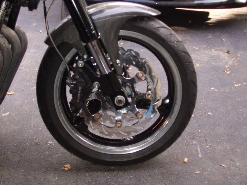

Well, after some tears and such, we get to building, and finally we get this.  I fired her up this afternoon and DAMN she sounds good.
Mods:
1993 GSXR 1100 Forks with Racetech Springs
1993 rear wheel assembly with 93 brake
Dynojet Stage 3 kit with K&N Pods
6-piston Hayabusa Calipers
Wave Rotors
Bandit 400 Gauges.
So, I'm inches from a test ride, just waiting to cut down the chain and get the finished spacers for the front wheel.  I do think I need to work on the carbs to get them running right, but she'll be good to go real shortly.

I really dig what you've done with that bike.  I've got similar plans for the 83 GS750 Katana I've just picked up.  What was involved with mounting that front end?
Offline Druro
  • Posts: 982
  • Noel... stay outta my profile... wanker.
Re: The unintended major project/surgery
« Reply #4 on: Oct 01, 2007, 23:58:13 »
Actually, it's stupid easy.  It's basically unbolt old front end, bolt in new....  that's it.   The only real item to adjust is the stops.  To do this i mounted some bolts in the existing stops on the GSXR triple to make sure it didn't smack the tank.  Other then that...  nada.  Just keep in mind that the forks+rim off the GSXR are far shorter then those on a GS (or Katana, in your case)
Wow, thats what I wanted to hear!  I have never had a bike with anti-dive forks before, and really don't even want to mess with them, so I'd much rather swap to a cartridge front end.  I don't mind the drop in front, as I'm looking to increase rake anyway.  Have you measured your trail with that setup yet?
How well do your CV carbs like those pod filters?
What shocks are you running?
I'm currently on the lookout for a GS1100 motor, as it'd be an easy swap.
As for the trail, I haven't checked this.  This swap is VERY popular in the GS world (check out www.thegsresources.com).
I haven't really tested the carbs with the pods yet.  The carbs do have a dynojet kit in them, setup for the pods/exhaust.  It does response REALLY fast at idle, so I can't wait to really try it out.
The shocks are progressives.  I don't know which model, but I'm going to be looking out for some cheap Works shocks or Ohlins.
Trust me, you'll LOVE the 1100 motor.  It's not huge on horsepower, but it's got TONS of torque from 3k to redline.
