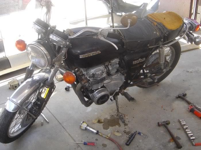

I found the bike about 100 miles away from my house. (I live in Los Angeles) When I found it I asked they guy whats wrong with it. He said, " I dont have papers, I dont know whats wrong with it, and the motor is seized." I said..... " Perfect!" I picked it up for $400 complete. Here are some pictures of it when I took it home.

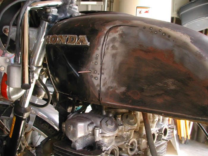

I also started the tank knee releifs. Some other people was poking at me for doing knee releifs but fuckk it.. I like the way it looks. (with my clubmens... hahaha)
fits like a glove

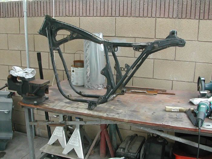

Alright. I got up this morning and Id thought Id do a little work on my bike. Last week I took the bike down to a rolling chassis. No today Id thought to get it down the frame so I get get the parts chromed and powdercoated. So this is what I did this morning.
got the frame down to bare frame. now it was time to do some cutting and grinding

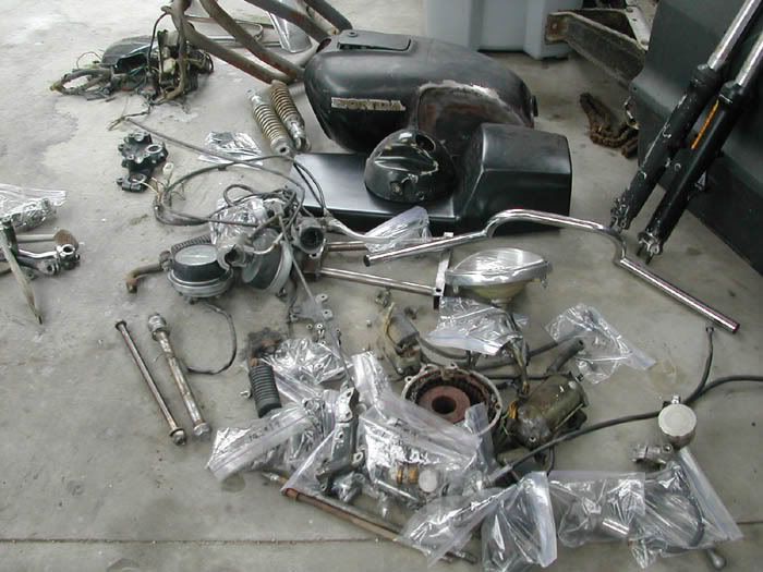

I bagged and tagged all parts and sorted it out to whats going to get chromed and powdercoated and polished. all hardware was sorted out to get replaced with stainless steal allens
motor is getting ready for a rebuild. I guess Ill start doing it after I drop all the other parts for chrome/polish/powdercoat So when they get back. everything will be ready to be put back together.
