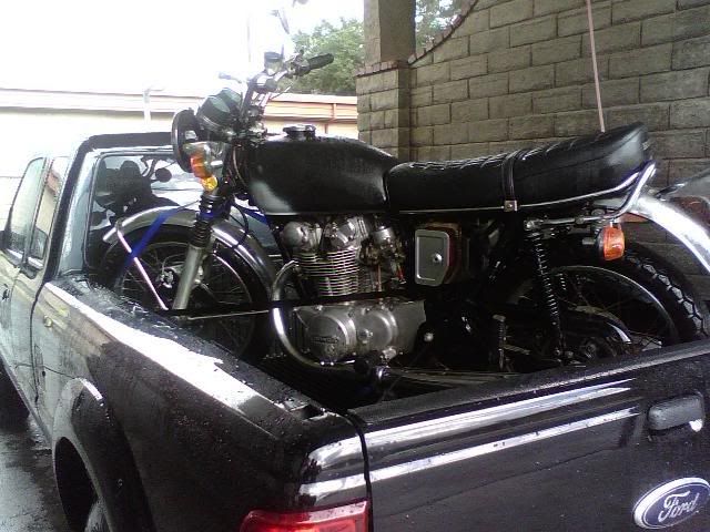

I took some pictures using my sidekick. Here's one of the bike loaded on the truck.

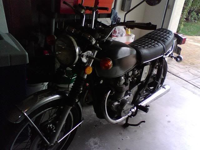

And sitting in my garage.

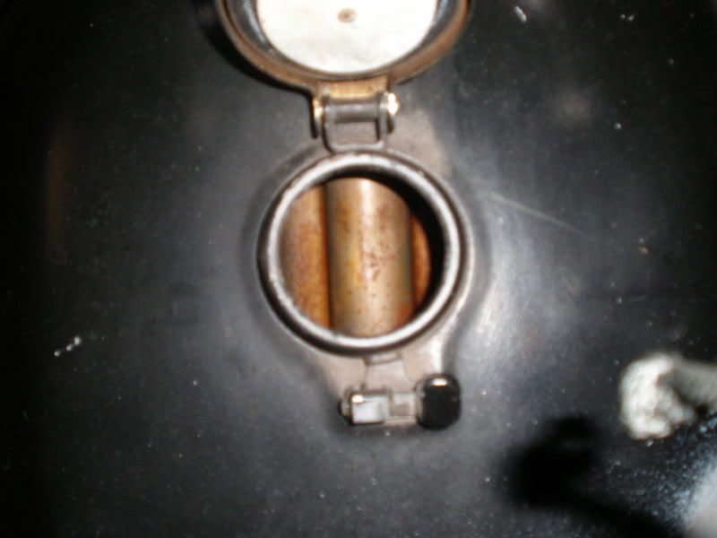

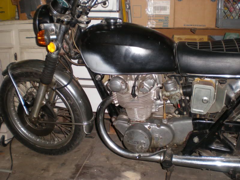

Here's a couple of pictures that the guy sent me.
As you can see, the tank has a lot of rust in it. The bike was in decent condition: Has the usual rust, but it's currently not running. The bike kicks all the way through, so the engine isn't seized. The guy told me that the bike has been accidentally dropped twice on it's left side, hence the dent on the tank, which his father bondo'd, bent left turn signal, and bent/loose shift lever. The battery was dead as well, so no way of checking the turn signals or headlight. Or horn. Honk honk.

How long has it been sitting?  Dump that old oil & change it.  Hopefully there isn't any old gas in the carbs, because they could be varnished up pretty bad if it's been sitting for a few years.
After electrolysis, the tank will flash rust pretty quick.  Might want to coat it with Por15 or a similar product (last thing you want is rust in the carbs.)
